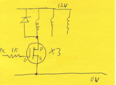

It gets lots better than this, though. While I was getting my head around this kind of motor I realised that UNLIKE regular stepper motors it doesn't need polarity control on the windings. As a result you can run the one I'm designing with three standard power transistors like the TIP110 that everybody is familiar with. While the TIP110 will handle 2 amps/winding, way back when I bought a sack full of BD681. Those are rated at 4 amps. :-D

Much better to use MOSFETS as they don't waste 2V and get hot.
I'm pretty sure that I've got half a dozen lying around here somewhere. I toyed with the notion of making a high amperage stepper controller from discrete parts at one point and bought most of the parts. :-)
Yup, I remembered correctly. Got 6 MOSFETS. HUFA76419P3's rated for 20 amps and 60 volts. That's serious overkill, but what the hell. I've had 'em laying around for years now.
Thanks for the heads up, Nop! :-)
Yes they should do the job without the need for heatsinks.
It is a good idea to put a resistor in series with the gate, say 1K :-
It limits the current the PIC has to provide when charging the gate capacitance.
It slows down the switching slightly. You don't want really fast edges when driving a stepper as it just gives more switching noise.
It can also reduce a tendency to oscillate when the gate is driven with a low impedance.
Of course don't forget the back EMF diode.
LOL! A sketch would be useful. I am an AMATEUR, you know. :-P

Ah! As they say, a pic is worth a thousand words. :-D
Thanks!
